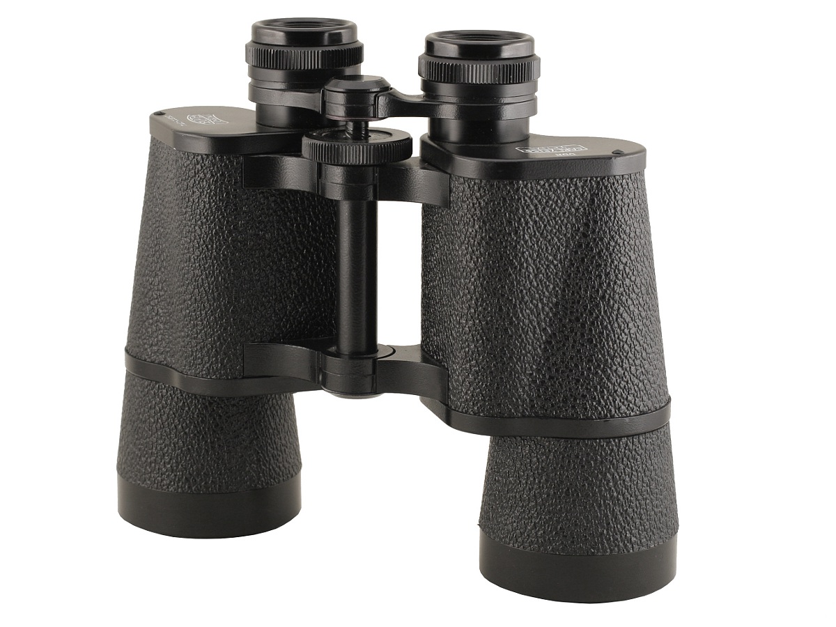

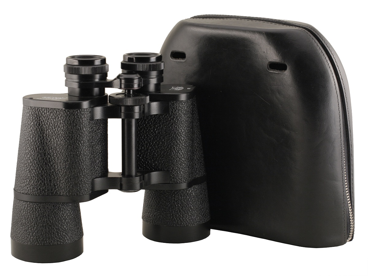

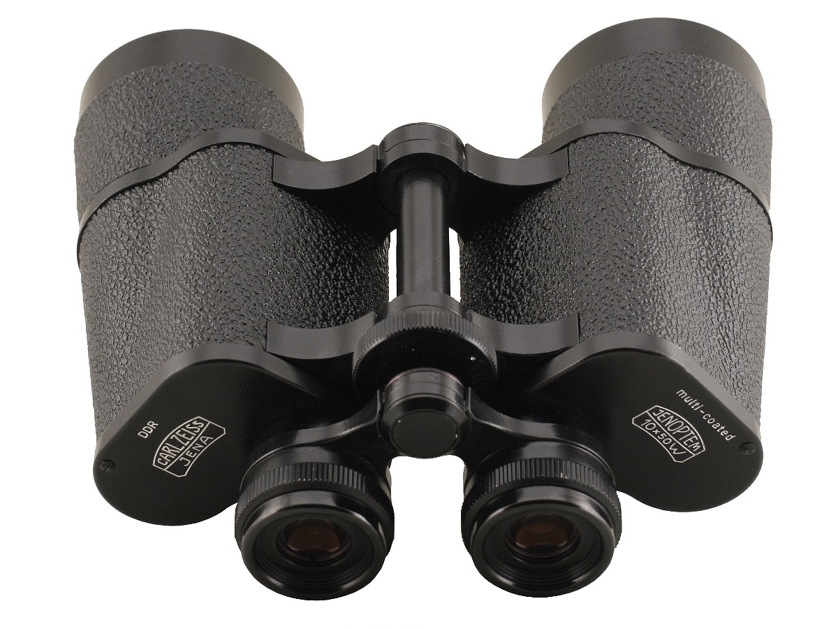

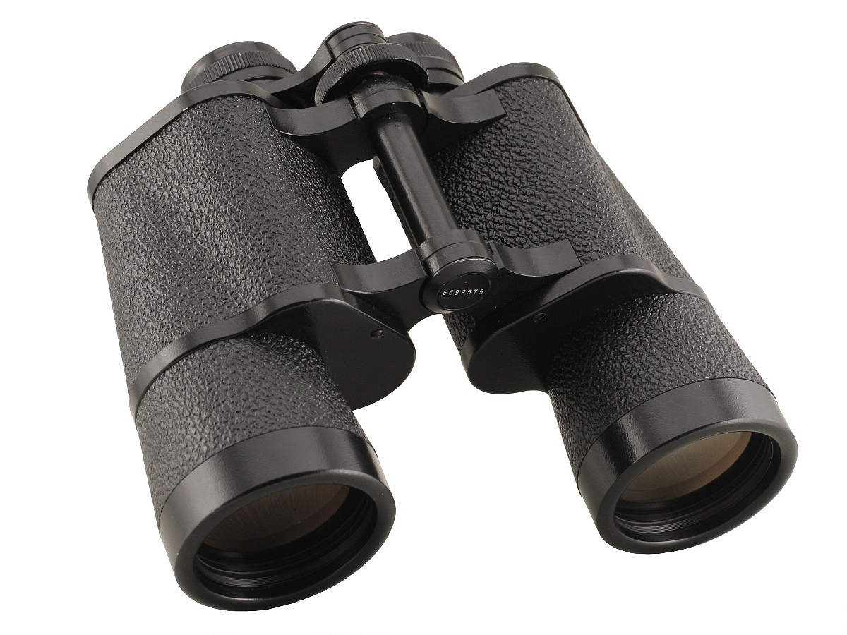

  • Lornetka Carl Zeiss Jena Jenoptem 10x50W
