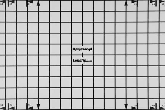

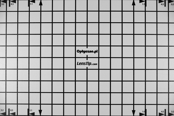

Canon 50D, 70 mm
Canon EF 70-200 mm f/2.8L IS II USM - Dystorsja

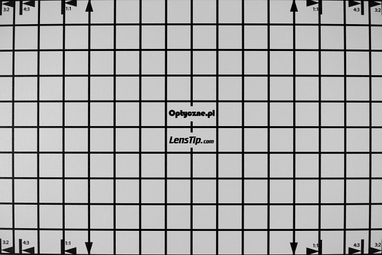

Canon 50D, 135 mm

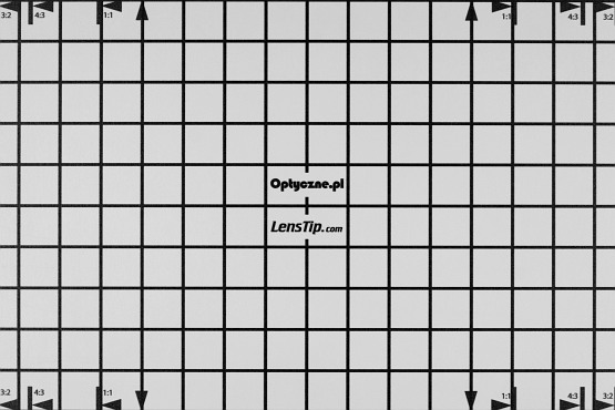

Canon 50D, 200 mm

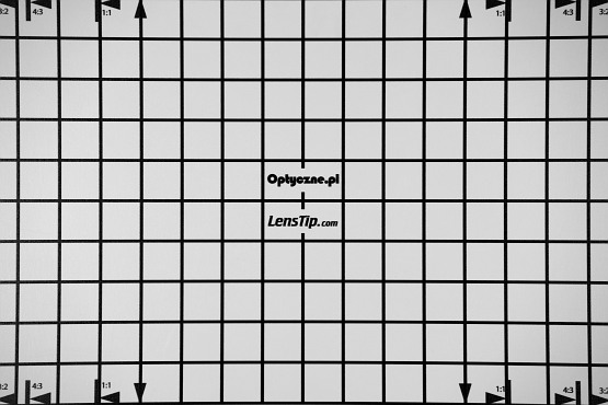

Canon 50D, 280 mm (TC 1.4x)

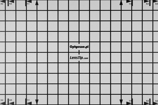

Canon 1Ds MkIII, 70 mm

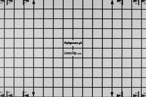

Canon 1Ds MkIII, 135 mm
Canon 1Ds MkIII, 200 mm
Canon 1Ds MkIII, 280 mm (TC 1.4x)
