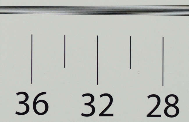

A7R III, JPEG, 20 mm, f/2.0

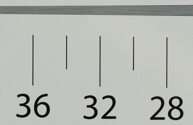

A7R III, JPEG, 20 mm, f/2.8
