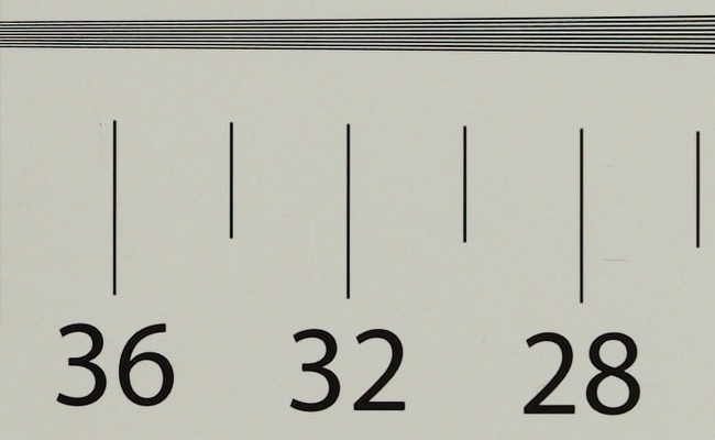

A7R IIIa, JPEG, 16 mm, f/1.8

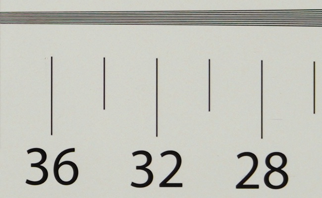

A7R IIIa, JPEG, 16 mm, f/4.0
