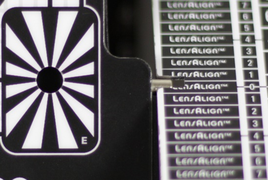

50D, f/1.8
Canon EF 50 mm f/1.8 STM - Autofokus
5D Mk III, f/1.8
