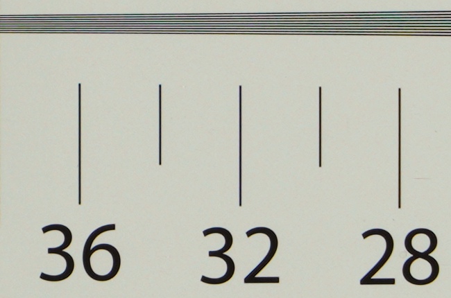

A7R IIIa, JPEG, 17 mm, f/8.0

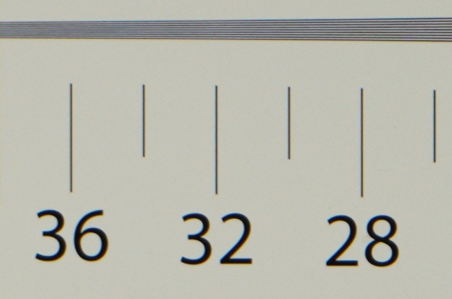

A7R IIIa, JPEG, 50 mm, f/4.0
