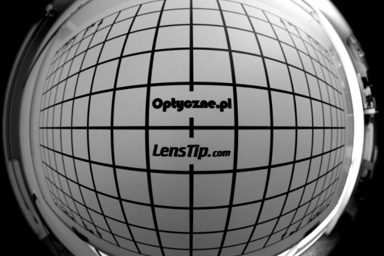

Canon 50D, 8 mm
Canon EF 8-15 mm f/4 L Fisheye USM - Dystorsja

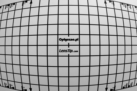

Canon 50D, 12 mm

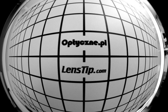

Canon 50D, 15 mm

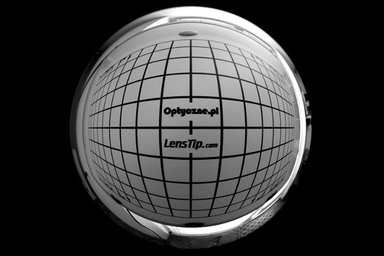

Canon 1Ds MkIII, 8 mm

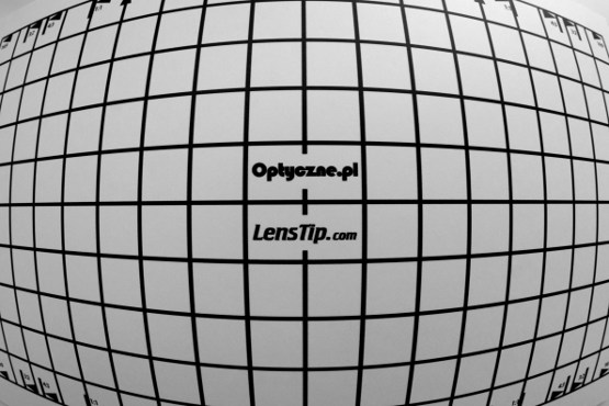

Canon 1Ds MkIII, 12 mm

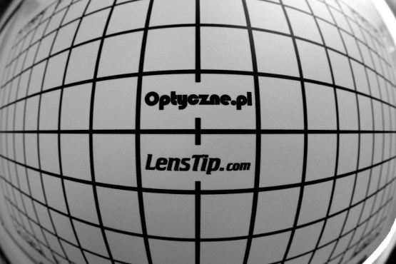

Canon 1Ds MkIII, 15 mm
