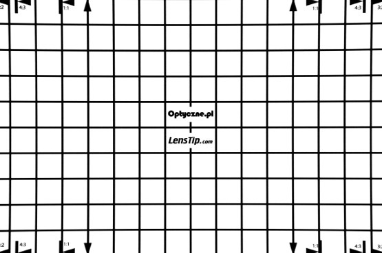

Nikon D7000, 18 mm
Sigma C 18-300 mm f/3.5-6.3 DC MACRO OS HSM - Dystorsja

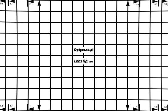

Nikon D7000, 35 mm

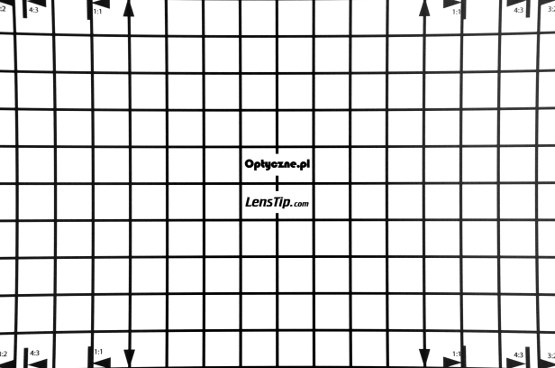

Nikon D7000, 50 mm

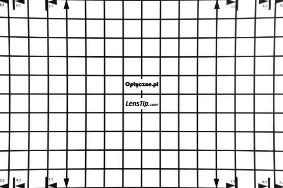

Nikon D7000, 100 mm

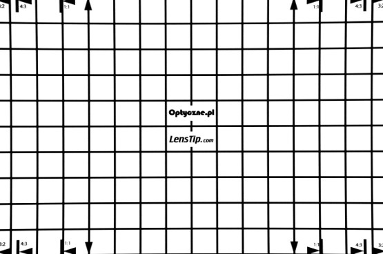

Nikon D7000, 200 mm

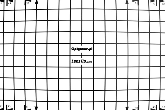

Nikon D7000, 300 mm
