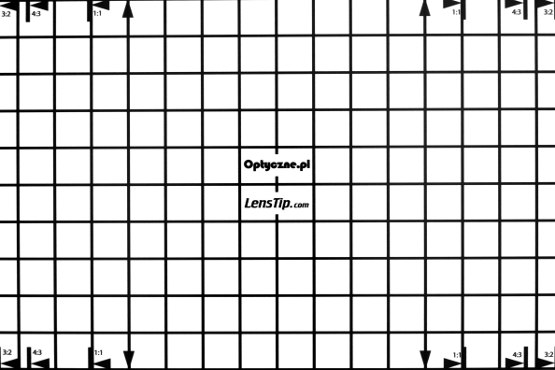

Canon 50D, 11 mm
Tokina AT-X PRO DX 11-20 mm f/2.8 - Dystorsja

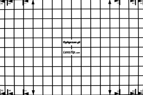

Canon 50D, 16 mm

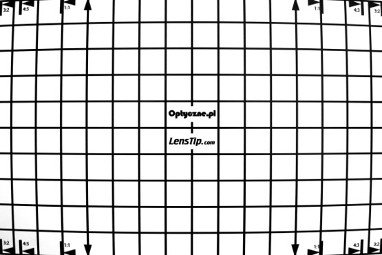

Canon 50D, 20 mm
