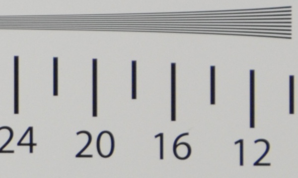

Nikon D3x, JPEG, 24 mm, f/4.0

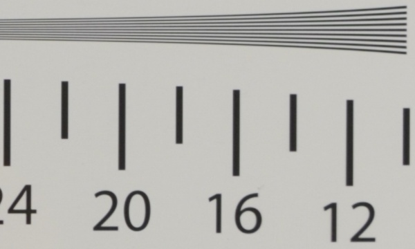

Nikon D3x, JPEG, 70 mm, f/2.9
