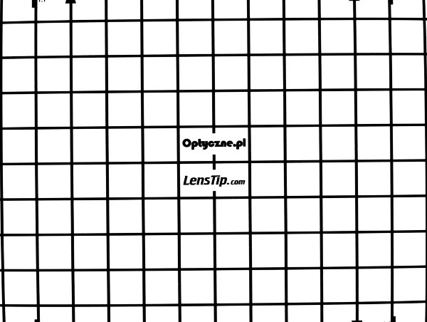

Olympus E-PL1, 300 mm, JPEG
Olympus M.Zuiko Digital 300 mm f/4.0 ED IS PRO - Dystorsja

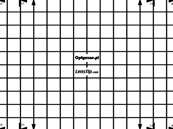

Olympus E-PL1, 300 mm, RAW

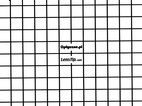

Olympus E-PL1, 420 mm (TC), JPEG

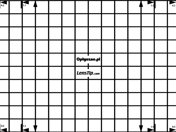

Olympus E-PL1, 420 mm (TC), RAW
