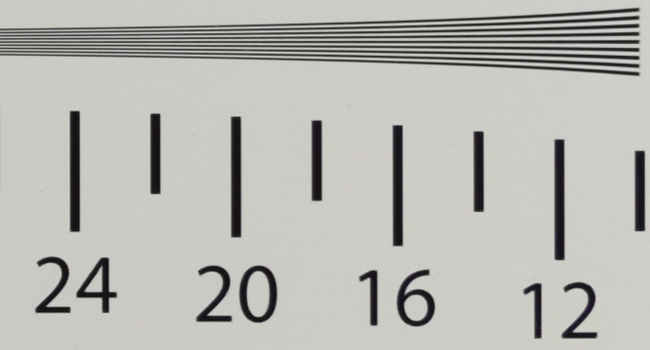

Fujifilm X-T2, JPEG, 15 mm, f/3.5

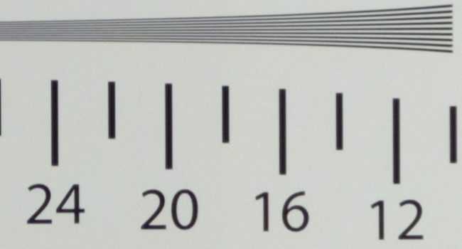

Fujifilm X-T2, JPEG, 45 mm, f/5.6
