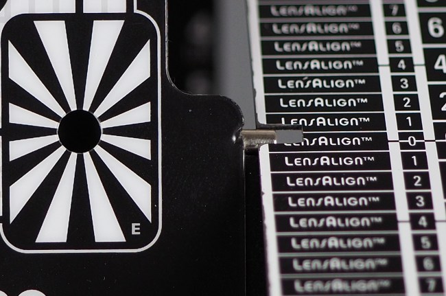

Panasonic DMC GX9, 25 mm, f/1.7
Panasonic Leica DG Vario-Summilux 10-25 mm f/1.7 ASPH - Autofokus

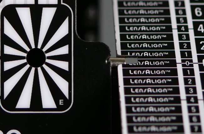

Olympus E-M5 II, 25 mm, f/1.7
