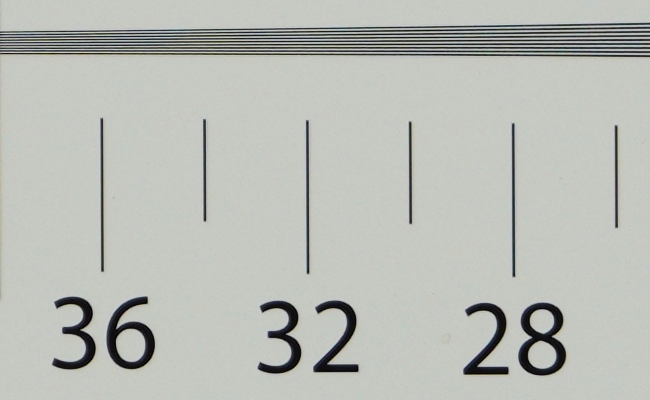

A7R III, JPEG, 30 mm, f/4.0

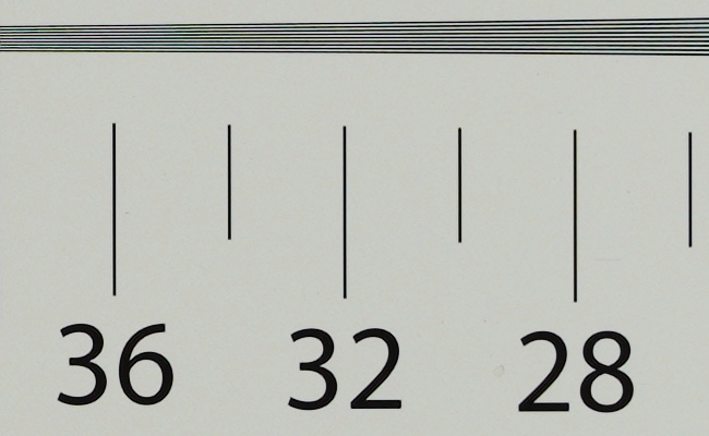

A7R III, JPEG, 40 mm, f/2.8
