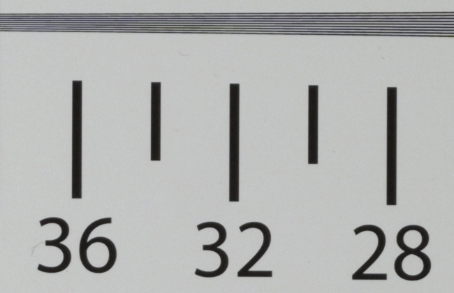

Nikon Z7, JPEG, 600 mm, f/6.3

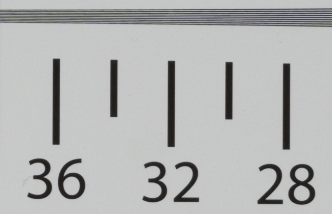

Nikon Z7, JPEG, 600 mm, f/8.0
