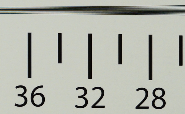

A7R II, JPEG, f/2.0

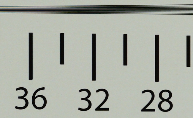

A7R II, JPEG, f/4.0
