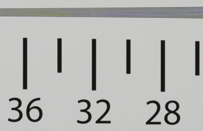

Nikon Z7, JPEG, 70 mm, f/2.8

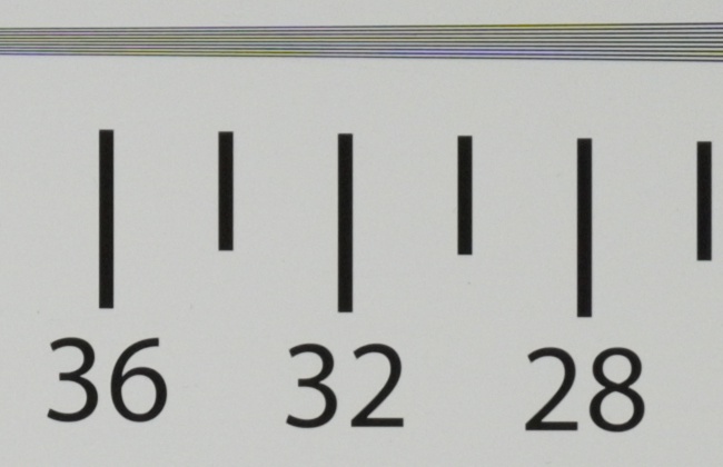

Nikon Z7, JPEG, 200 mm, f/2.8
