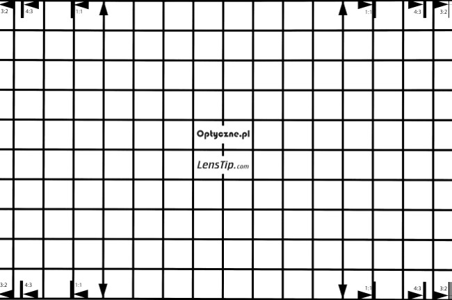

Sony A7R III, 50 mm, JPEG, APS-C
Sony FE 50 mm f/2.5 G - Dystorsja

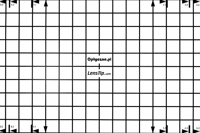

Sony A7R III, 50 mm, JPEG, FF

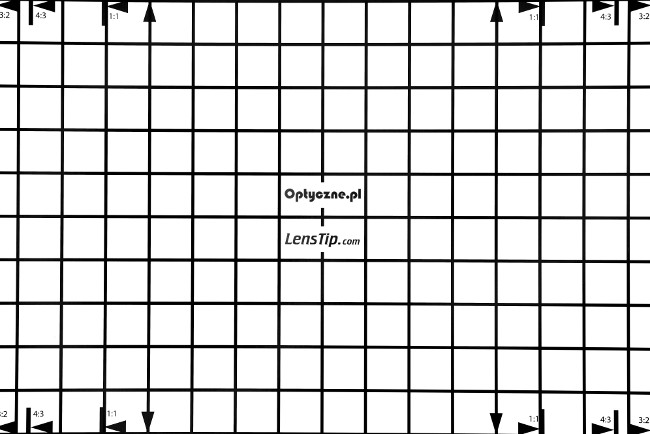

Sony A7R III, 50 mm, RAW, APS-C

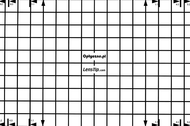

Sony A7R III, 50 mm, RAW, FF
