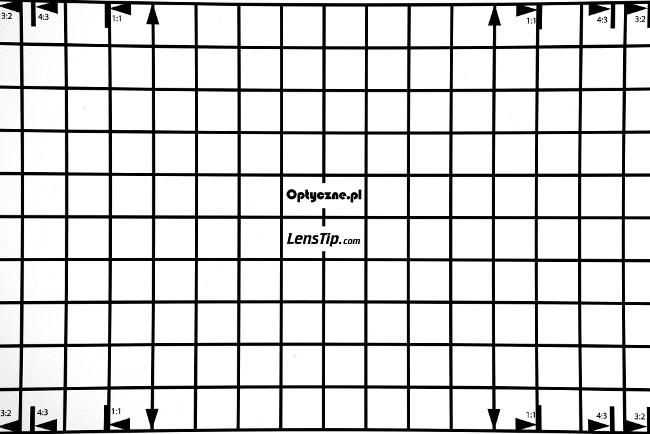

Sony A7R III, APS-C, JPEG, 70 mm
Sony FE 70-200 mm f/2.8 GM OSS II - Dystorsja

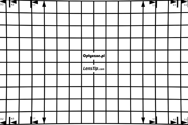

Sony A7R III, APS-C, JPEG, 100 mm

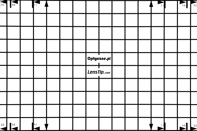

Sony A7R III, APS-C, JPEG, 135 mm

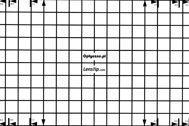

Sony A7R III, APS-C, JPEG, 200 mm

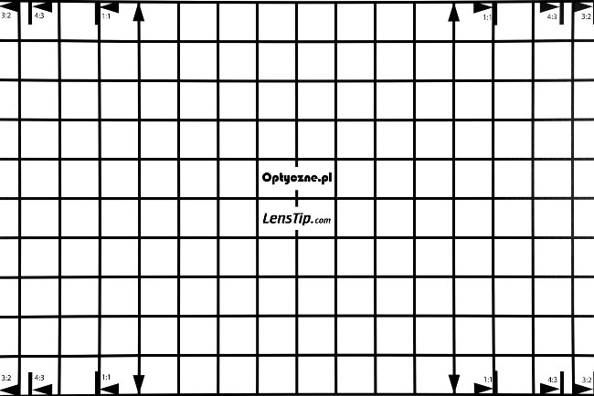

Sony A7R III, FF, JPEG, 70 mm

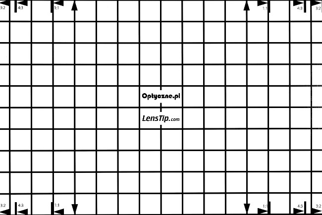

Sony A7R III, FF, JPEG, 100 mm
