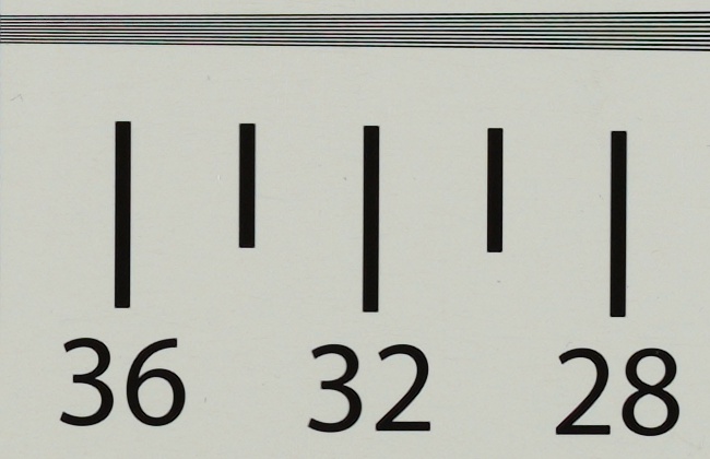

A7R III, JPEG, 24 mm, f/2.0

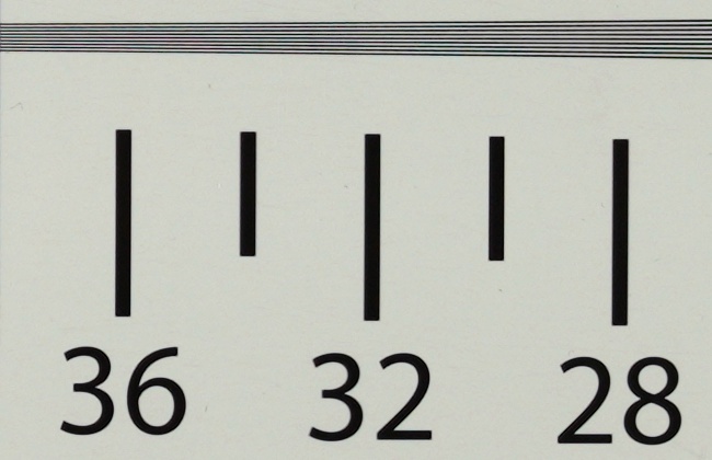

A7R III, JPEG, 24 mm, f/4.0
