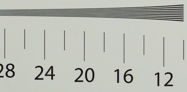

Sony A7R III, JPEG, 10 mm, f/4.0

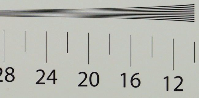

Sony A7R III, JPEG, 20 mm, f/4.0
