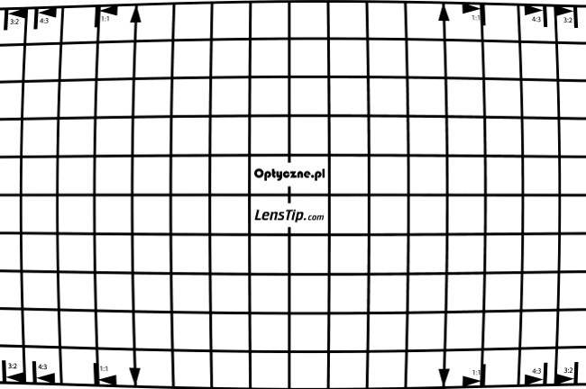

Sony A7R III, APS-C, JPEG, 10 mm
Sony E PZ 10-20 mm f/4 G - Dystorsja i pole widzenia

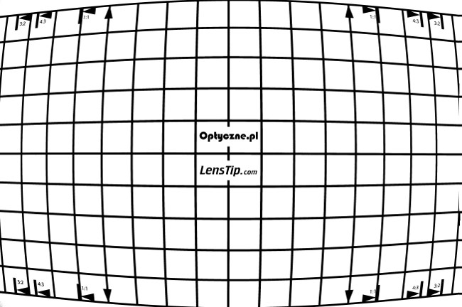

Sony A7R III, APS-C, JPEG, 15 mm

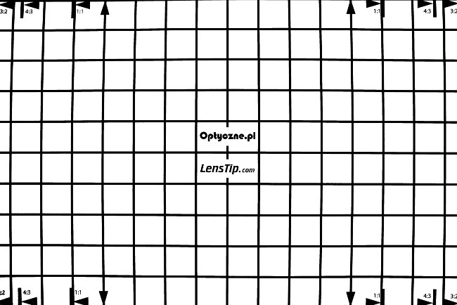

Sony A7R III, APS-C, JPEG, 20 mm

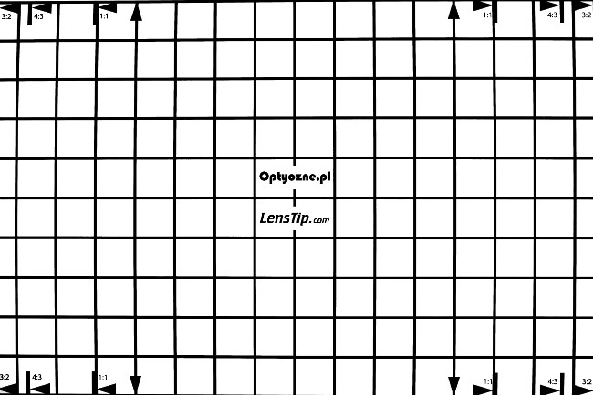

Sony A7R III, APS-C, RAW, 10 mm

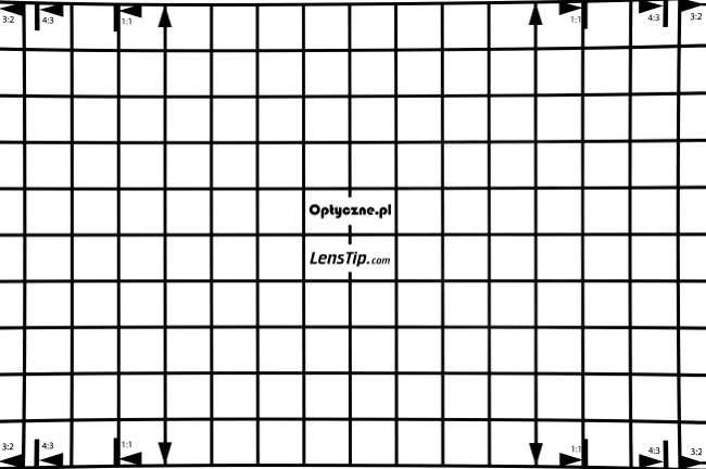

Sony A7R III, APS-C, RAW, 15 mm

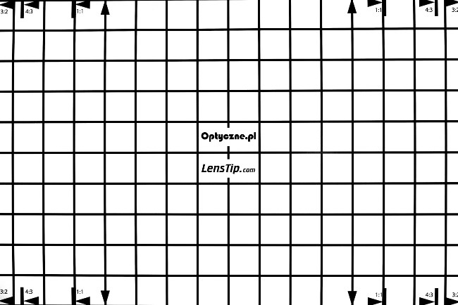

Sony A7R III, APS-C, RAW, 20 mm
