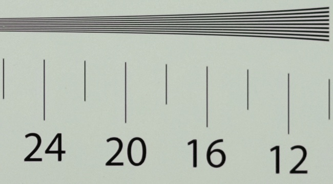

Fujifilm X-T2, JPEG, f/1.2

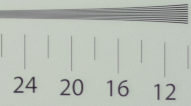

Fujifilm X-T2, JPEG, f/4.0
