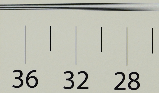

A7R IIIa, JPEG, 70 mm, f/2.8

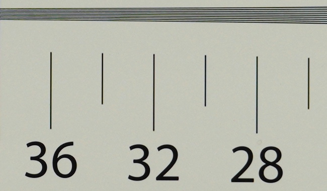

A7R IIIa, JPEG, 125 mm, f/2.8
