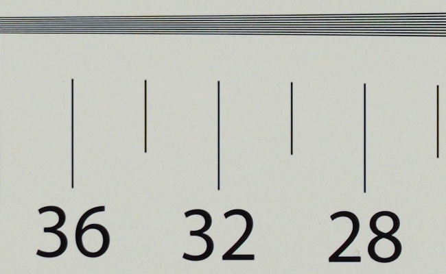

A7R IIIa, JPEG, 35 mm, f/2.0

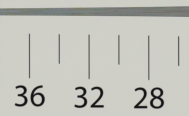

A7R IIIa, JPEG, 70 mm, f/5.6
