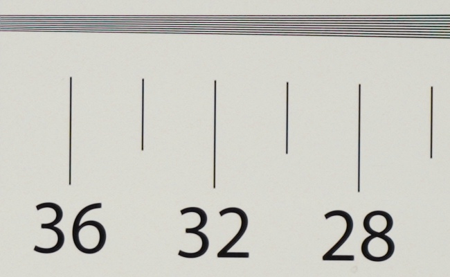

A7R IIIa, JPEG, 85 mm, f/1.4

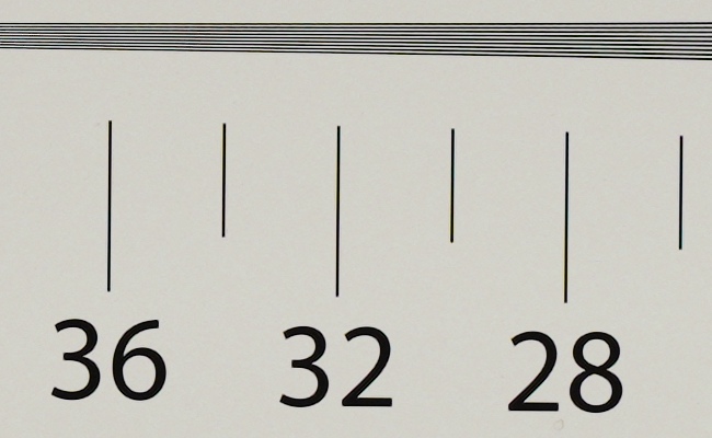

A7R IIIa, JPEG, 85 mm, f/2.8
