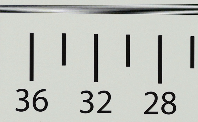

A7R III, JPEG, 50 mm, f/2.5

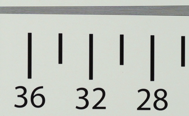

A7R III, JPEG, 50 mm, f/4.0
