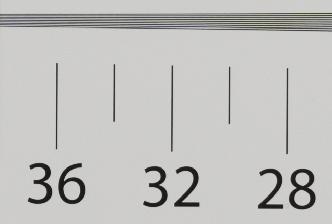

Nikon Z7, JPEG, 28 mm, f/1.2

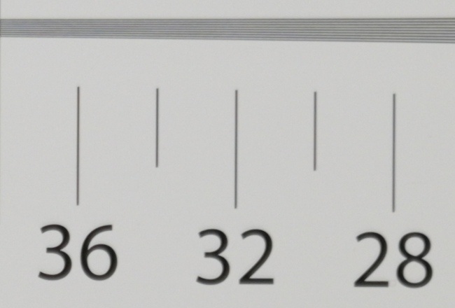

Nikon Z7, JPEG, 28 mm, f/8.0
