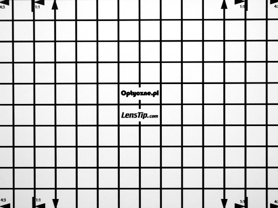

Olympus E-PL1, 12 mm, JPEG
Olympus M.Zuiko Digital 12-50 mm f/3.5-6.3 ED EZ - Dystorsja

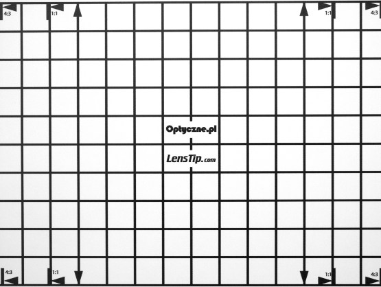

Olympus E-PL1, 26 mm, JPEG

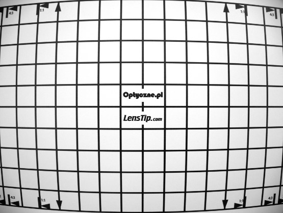

Olympus E-PL1, 50 mm, JPEG

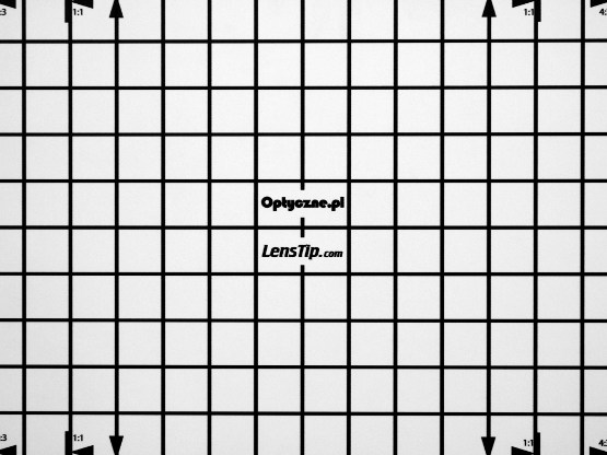

Olympus E-PL1, 12 mm, RAW

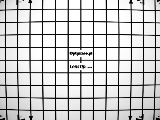

Olympus E-PL1, 26 mm, RAW

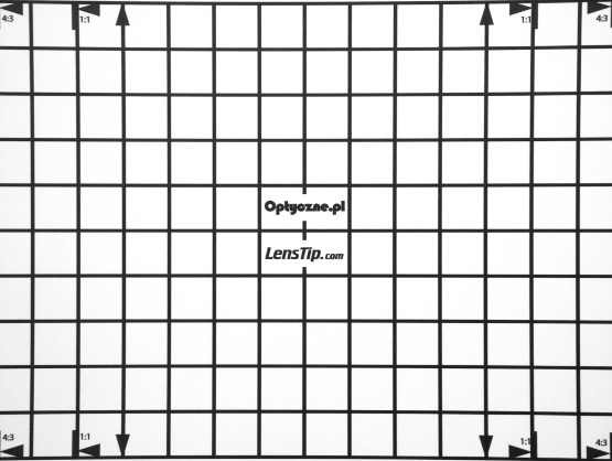

Olympus E-PL1, 50 mm, RAW
