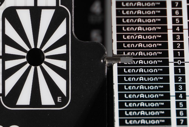

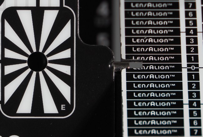

Olympus E-M5 II, 90 mm, f/3.5
OM System M.Zuiko Digital ED 90 mm f/3.5 Macro IS PRO - Autofokus
OM System OM-1, 90 mm, f/3.5
Olympus E-M5 II, 180 mm (TC), f/7.1
OM System OM-1, 180 mm (TC), f/10.0
