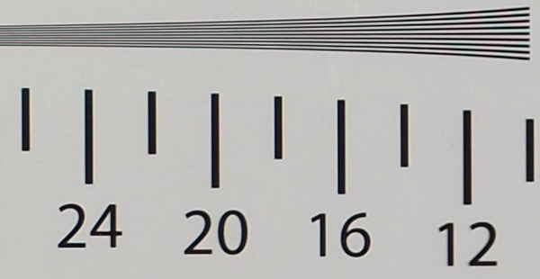

Olympus E-M5 Mark II, JPEG, 8 mm f/2.8

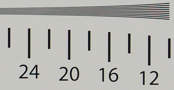

Olympus E-M5 Mark II, JPEG, 13 mm, f/4.0
