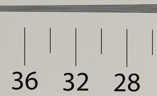

A7R IIIa, JPEG, 35 mm, f/1.2

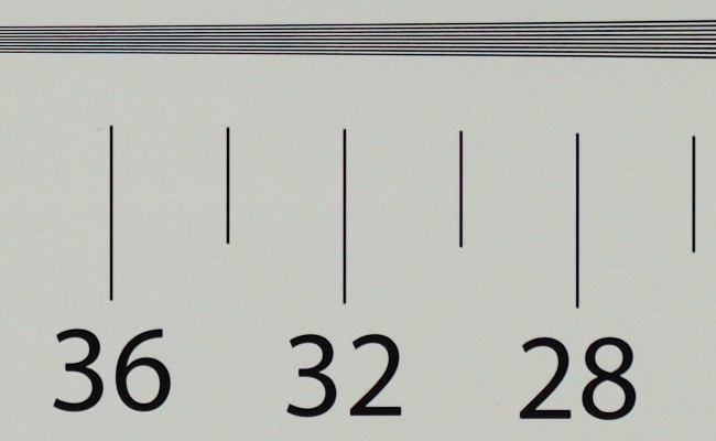

A7R IIIa, JPEG, 35 mm, f/2.8
